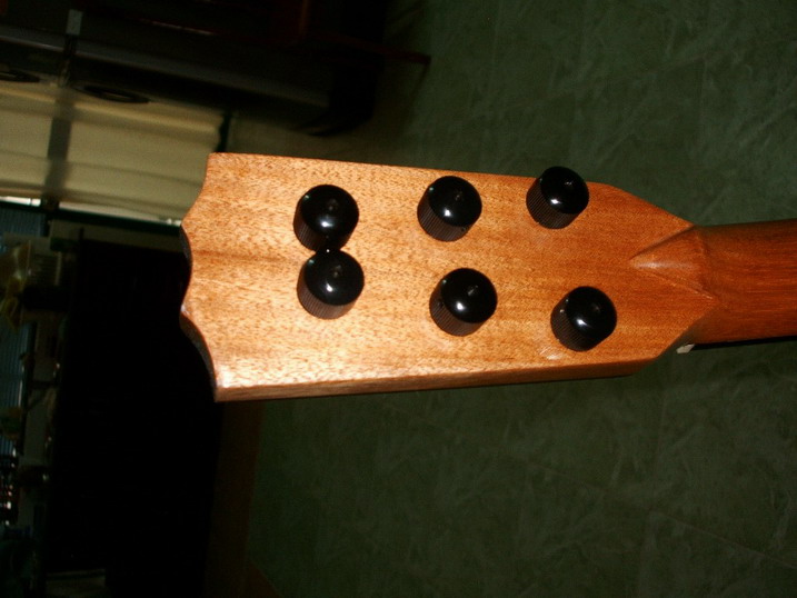

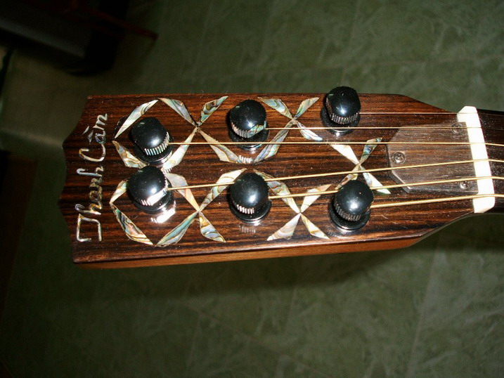

They probably look ugly to traditionalists but I love to use them. Extremely accurate at 40:1, not protruding so much and easy to use.

I was thinking or trying this type of tuner on a twelve string. How do you like their operation from a players stand point?

Interesting. Where'd these come from?
I actually don't like high gear ratios -- 40:1 sounds like a nightmare to me. Still, though, I can imagine applications where tuners like this could work well. Who makes 'em?

I like them in the 6 in a line layout better than 3 a side.
I could envision maybe using them on a futuristic electric or maybe a REALLY compact travel guitar.....
PostPosted: Wed Oct 04, 2006 12:02 pm
     Placement looks a little odd, but, I guess one doesn't have much of a choice. How well do they tune? I saw these and was very interested.
     40:1 does sound a little high, but I was wondering how this is figured considering these work up and down, right, and not rotational!
     It's cool seeing them used. This is the first for me.

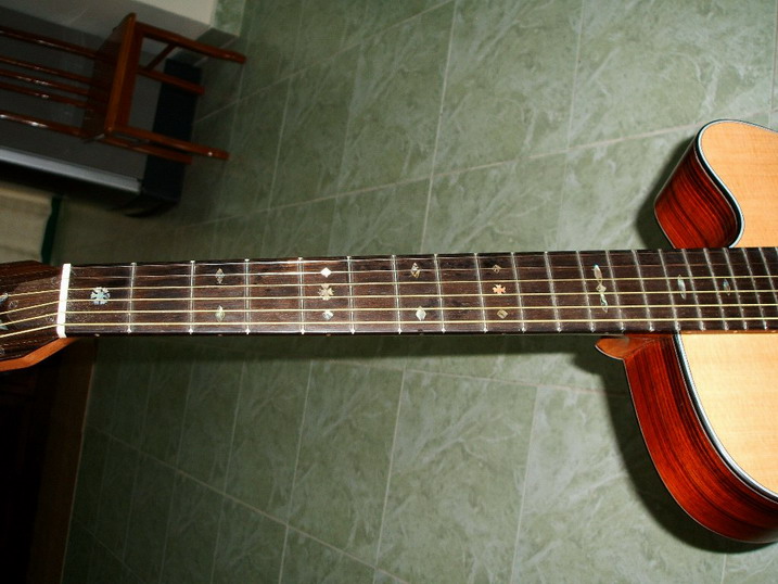

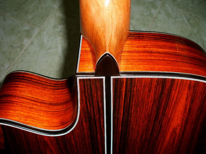

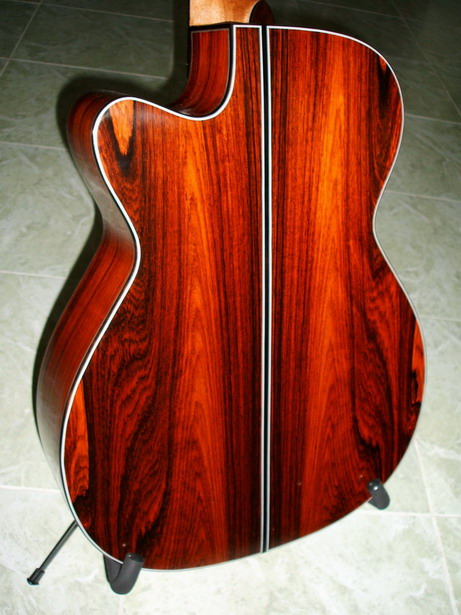

#3 - An OM cutaway with sitka top, Brazilian rosewood back and sides, mahogany neck, ebony headstock cover, fretboard, bridge and binding. (see pictures as requested)

They are really easy to adjust but I am not sure how good they would be if you change back and forth to alternate tunings. If I use them again I would consider 6 inline or staggering the 3 on each side. They look ok from the front but the top 2 look a little strange from the back although tuning is no problem.
Here are pictures as requested:

The 40:1 ratio does seem problemary but actually you just pull the string a little lower than the desired note, lock it down and then just do some fine tuning.
PostPosted: Wed Oct 04, 2006 8:50 pm
I have nothing against the design, but like the others would have a problem with the ratio. The 16:1 of Waverly's is about as high as I like to go and in fact prefer the 12:1 of the vintage Schaller. Perhaps it's because I'm used to the 1:1 of lute pegs!
Nice workmanship Cecil.

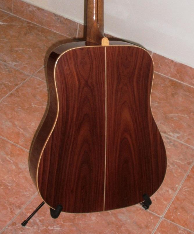

This is on sample of local Vitenamese rosewood used on a student grade guitar.

    I think the main concern would be spacing. If you look at Cecil's headstock the tuners chevron to center, to escape interference with the size of the lock down knobs.
    This is not so much of a problem with a standard tuner because of pin size being so much smaller. As I see it.
